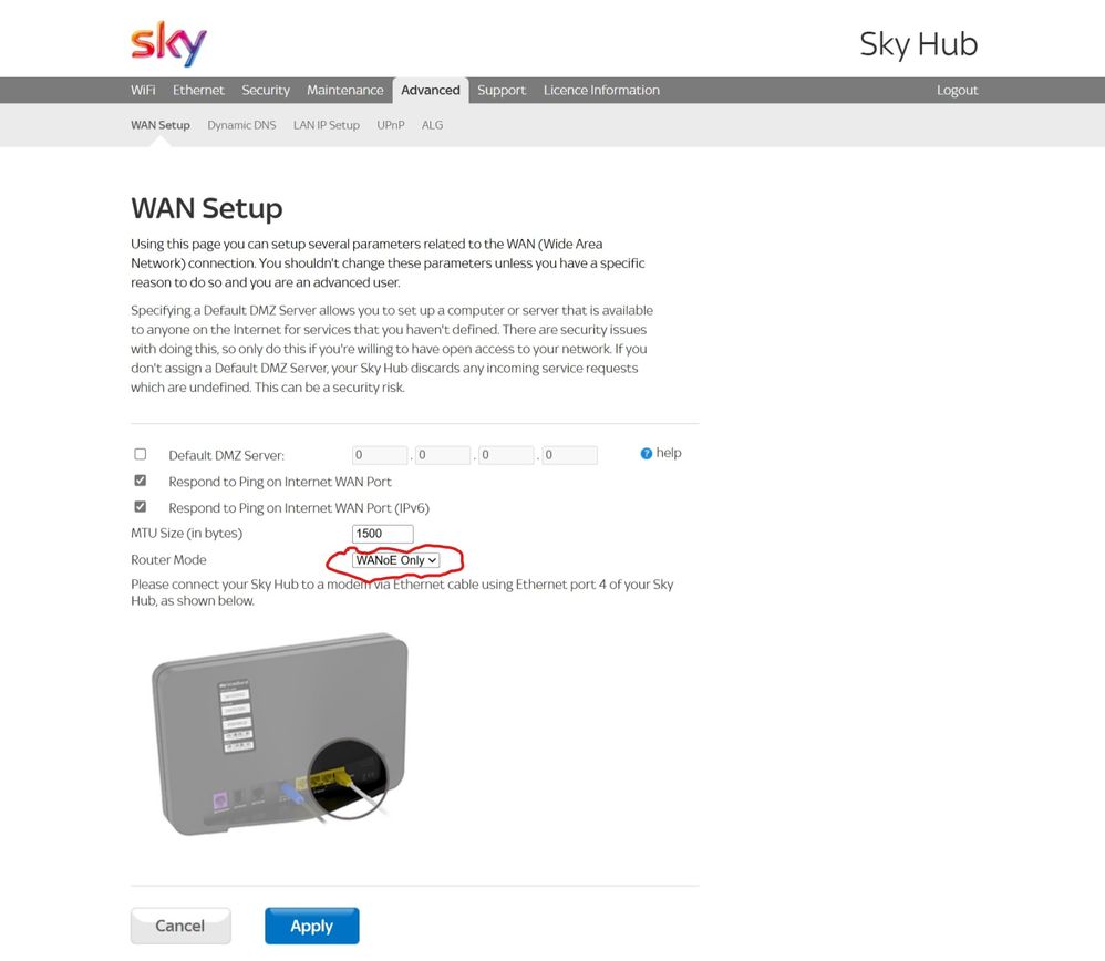

I have recently upgraded to Fibre and all works well. However if the Hub is switched off for any reason, it takes 20 mins before the internet connection comes up again. Any ideas ?

@DarrenAbbott 20 mins is just such a long time, only setting i can think worth looking at see the picture below once it clears for viewing!
Default is Auto changed to WANOE!

@DarrenAbbott Seems a long time, normal is around 4-5 minutes from on to active! What hub and service do you have!

Thank you for the response and the sky info.
We are on Sky Fibre 300mbs through a Sky Broadband Hub. The Fibre is definately up and running with 4 green lights.
The sky hub goes green for power and WiFi quite quickly. Then 20 mins later th einternet goes green and eventually the telephone line.

Genius, up and running in just over 4 minutes after the change. Many thanks

@DarrenAbbott Glad it helped, sounded like it was flip/floping about the DSL/Wan and not sure where to go look for the wan connection!
