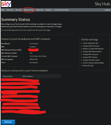

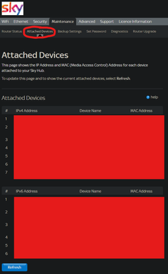

If you log onto your routers web panel (in the url of your browser type "192.168.0.1")
1. Press maintenance
2. press attatched devices
Attatched devices will show you the devices on your network (wifi or ethernet). Are there any devices on the list which you dont recognise? This is just to mitigate the thought of unwanted actors on your network! Let me know, cheers
