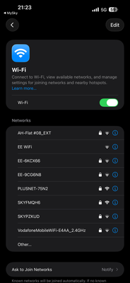

Since this morning I’ve been facing the same issue: I’m unable to connect to Wi-Fi because my broadband network does not appear in the list of available connections, and I’m also unable to connect via the QR code. I’ve reset the hub multiple times with no success, and my Sky Wi-Fi network still isn’t showing in the selection list.
When I check the connection through the Sky app, everything appears to be fine, yet I still cannot use the Wi-Fi. I also cannot access the router via its IP address — it simply won’t connect.

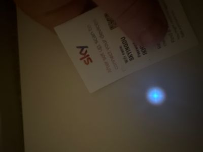

@Max281 Have you tried a full factory reset on it, hold the wps button in watching the light on the front, takes 10-30 seconds with the hold, allow to reset and see where it goes!
Does your card match the label on the bottom off the sky Max hub.
If you switch the hub off, what do you see when you scan for networks with your mobile, does one off those listed now disappear because the hub is off?

I did tried factory reset. But will try again with 30 second. After rebooting it's just go to white light but still not on the selection list...
yeah, label match the router. So all good.
