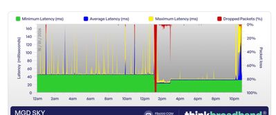

Speed test either works or it doesn't (i.e. 100/20 with 0 packet loss or the test gets stuck).
Tried rebooting the router and have a new IP (updated the BQM). Still issues.
I'll try removing all connected devices but don't hold to much hope.
Should have stayed on FTTC 😔.
Message posted on 10 Feb 2026 09:16 PM - last edited: 10 Feb 2026 09:19 PM
Re: Internet keeps dropping after switch to Full Fibre
@depulYou went offline just before 2pm till just before 4pm as far as the BQM is concerned and back on again with what looks like just the same condition of response to the sky Hub, which one are you using currently, the Broadband hub or the sky Max?#
Between the hours off 7-8pm you were perfect so what was going on at that time?

Yep that's when I rebooted. Left it powered down for a couple of hours before reconnecting it.
I'm still using the Hub 4 (SR203).
The Max Hub gives me a more stable connection but it still constantly drops. It's a shame I can't run the BQM on this.
I've requested a replacement Sky Hub which I'll also try.

@Michael+Dunlop Have you looked at his and my live BQM's posts 24/25...
Message posted on 10 Feb 2026 09:47 PM
@JimM1 I saw the one posted that looked incredibly similar to my BQM. I tried all the solutions with Sky hardware changed, reboots etc

@depul As you have the SR203 on line then use the tool below and look at your stat's, pay particular attention to the wan trafffic bytes in/out and to the wireless band to see what is going on!

@JimM1 I didn't do anything different between those hours. It's completely random. Sometimes the internet (and VOIP) lights will go amber. Sometimes the lights stay green but it's unusable.
@Michael+Dunlop seems like it is a hardware issue or a combination of the line and the hardware as the Sky Max Hub seems better and giving me a more stable connection. But both routers are not fit for purpose. Unfortunately I need the landline so I'm a bit stuck.
Message posted on 10 Feb 2026 10:05 PM
@depul Fully mindfull that you require the landline for operation that is why i have not suggested that you get a third party router, but your network is showing very unstable, and until you switch everything off and only have the hub on, let the BQM fall back so we see what is going on, i know this is a complete pain to do but sometimes needs must, just now it;s hard to say what is going on, that is why i posted up look at your stat's, when quite no wan traffic....

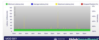

@depul If it helps. Over the past couple of days my BQM is looking much better. Albeit this a month in.

@Michael+Dunlop Super improvement, what a difference a real router does!
