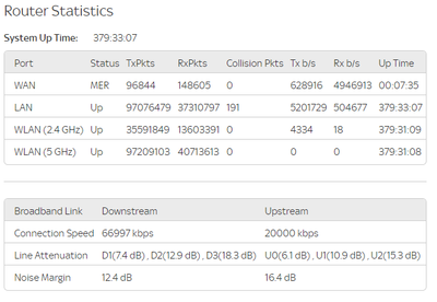

Could you post your router statistics

Hi,
Here are the Router Statistics:

You have raised noise margins part of which ,due to being so close to the cabinet are holding your speed to 80Mbps but also partly due to the beginnings of a line fault .
I would suggest your guaranteed speed is quite high and so may be worth calling sky
Could you also enter your full address below and post the table after removing your address from the image

Apart from the speed guarantee sky would consider it a line fault if the connection drops 10 or more times a day (24 hours)
