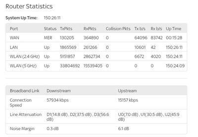

@JimmyGreen1 Do you feel from the link below that you could follow and post your own hub stat's up for viewing, if so give it a minute or so to fill the tables with data. It allows the look at the hub to see what is going on with the line to your hub! the picture capture that you see on the link is ideally what is needed to be viewed!

Sorry, I was away for the week and haven't been able to check the hub. Here's the screenshot I got. Most of the time the noise is at around 3.2 upstream and 6.2 downstream but, when it went wrong, it looked like this. At one point up and down were at zero.
Do you know why it would fluctuate this much?

That pic doesn't look the clearest, this might be better

@JimmyGreen1 Thanks 2nd picture is good, and you do have a line issue with the wan reset at just 15minutes before you posted and up over 150Hours total time, your same area security logs will show you how many times you are getting wan drops but they will only contain 24-36hours off useful data before it rolls over. Would run the diagnostic service checker, then have more fault's to get a better check, if nothing is found then you are going to have to call sky to get them to run a further diagnostic from there end.
The noise margin's do move a little but not way down to that value currently. Link below for the checker.
