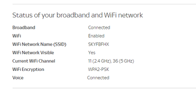

This is what it shows me

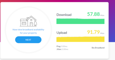

so this is what I have here below;

Those are not quite the router stats, please follow the instructions to the end
The speeds are quite odd, you are almost exactly at the speeds where the issue is almost alwsys down to being on 'Fast' ethernet (10/100mbps). But your PC is reporting 1000mbps. Your not running any sort of VPN or passthrough network interface are you?
What are the speeds like if you select other servers on speedtest.net?
