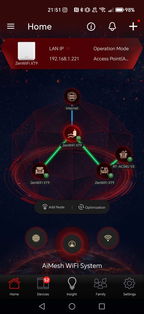

@JESSMC  Seeing as you  WFH, I would suggest you consider in investing in your own home network kit.
You don't need to spend a great deal to have a decent network for WFH. This is not to say Sky's WiFi boosters won't meet your needs, but I believe (stand to be corrected) that they are wireless repeaters. A mesh network should be better.
There are many brands to choose from, with many being very easy to set up and use.
A screenshot of my home network shows 52 devices connected. What it does not show are the speeds, which is fast in every room in my 3 storey home
Home network 3 storey houseHome network 3 storey house

Sky's pods/ mesh seems to be created for those who want something as close to plug in and play as you can get.
However,  for those who really need a good network around their home, I believe the investment in time and money  in a DIY home network is worth it.
My Asus XT9s are all connected wirelessly using a dedicated backhaul channel (tri-band).
From the first Asus XT9  in the hallway,  it connects to a second  XT9 which is at the back of a glass TV cabinet. My Apple TV, and Sky puck are connected using ethernet cables.
The Apple TV in the cabinet always records speeds of 850+ down and 90+ up.
In the first floor bedroom/home office, where my partner and I work- we always get speeds  of 400+ down and 90+ up connecting our computers to the XT9 with ethernet cables.
For the third floor I use an old  dual band Asus AC58U router so my partner can watch TV upstairs in her hobby room. Speeds up there are 150+ down and 70+ up.
