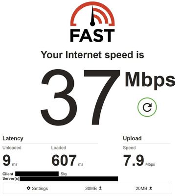

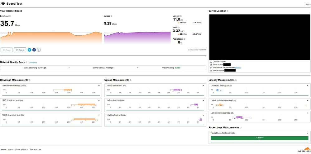

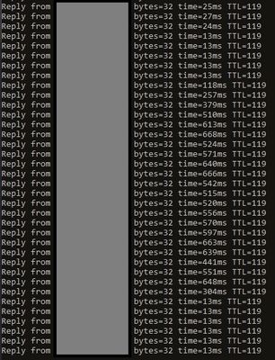

I'm experiencing high ping when using the white 'Wi-Fi Max' router (Model SR213).
Me and the wife game on separate platforms (PC and PS5, both wired ethernet connections) and are both experiencing the same lag when using the white SR213 router. This makes playing online shooters a horrible experience for both. We get NONE of these issues using the black SR203 router.
The bufferbloat on these new router models is insane. I know the Sky routers don't have QoS, but it was never this bad with the black SR203's.
My question is, is anyone else experiencing this? It seems nobody is talking about it.
I've had two white SR213 routers sent to me now and both do the same thing.
I've had an engineer visit too, who also brought with him another white SR213 router to test. Still the same issue. He was on the phone to his internal tech support for two hours while he was here, to no avail. He told me “These are new so we are still working it out"...
below are a few quick tests using the exact same wires/cables. Only swapping out the router hardware.
Tests using the white 'Wi-Fi Max' router (SR213)
cloudflare speed tests showing poor latencey
fast.com with the settings to show all metrics (so we can see latency).
pinging 'google.com' during these tests

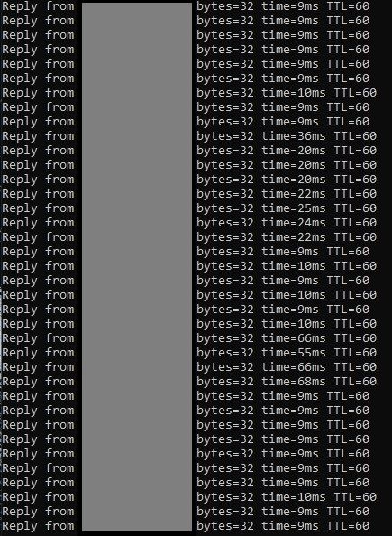

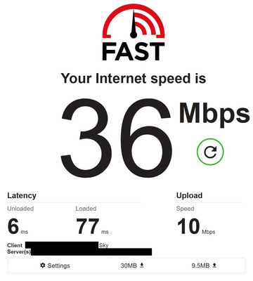

Tests using the black broadband router (SR203)

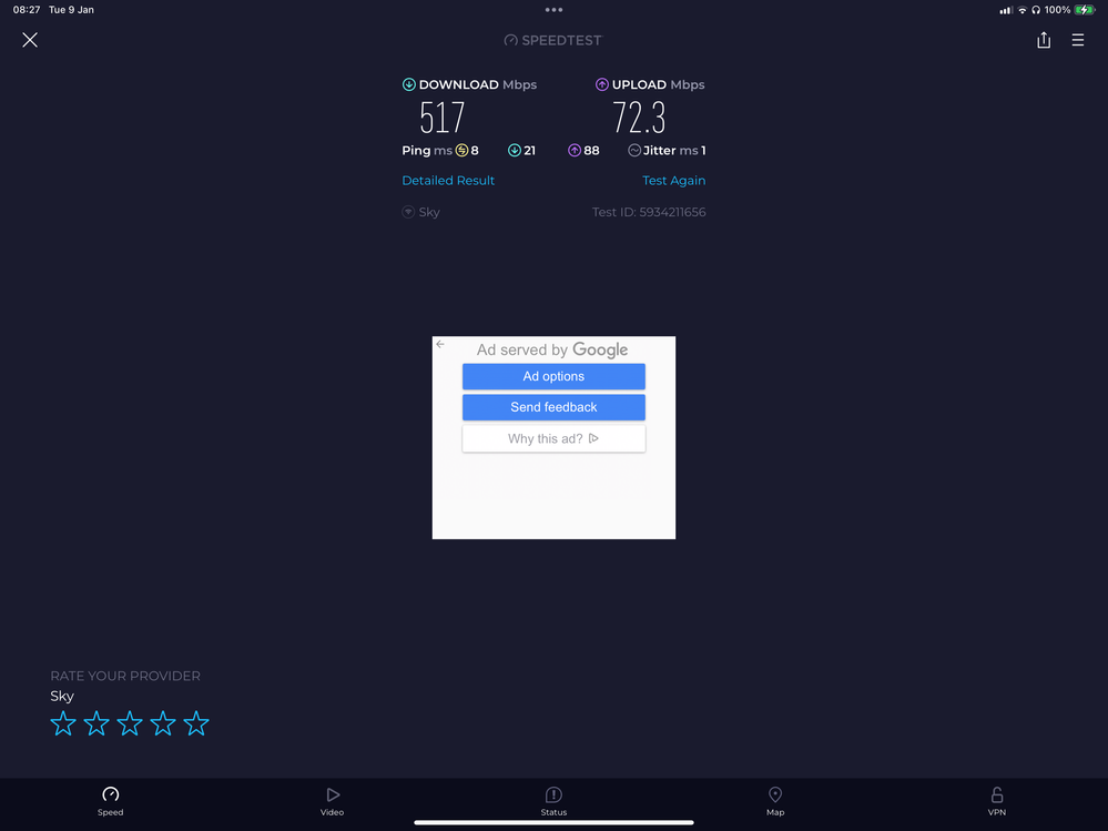

@miless IIRC there have been various reports of issues with the SR213 before including mysterious lateny issues. I am currently using one myself without any issue and my so it is not a universal fault with the unuts, see my system's speedtest.net result below. However my connection is full fibre so bypasses the modem stage while yours looks to be a FTTC connection.. What service is your friend on?

The tests were carried out using only my PC, connected via ethernet, with Wi-Fi disabled to negate anything else connecting and possibly causing unwanted spikes. No high bandwidth tasks running in the background. This is just one wired PC running each speed/latencey test one by one.
Of course, I get buying and using your own hardware is always going to be better than what an ISP can offer you for free (assuming you buy a more feature rich unit). This isn't my issue though.
I didn’t have these high latency issues with the SR203 router, which I have had for years now. The stark difference between performance for the SR203 and SR213, is night and day in my experience.
It’s so strange how the max hub is performing so bad in terms of latency.
What makes it worse is, I’m currently paying the extra for the max hub and its features, but I’m being forced to use the older hardware because of this which is frustrating.

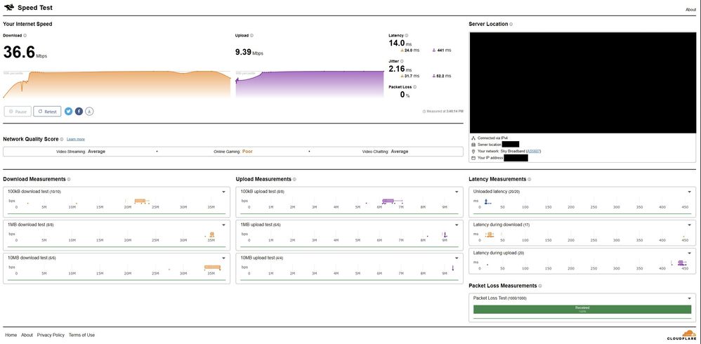

I recently tried the white max hub again just to see if any software updates has fixed this issue at all. Still does the same thing unfortunately. High latencey again just like the screenshots.
"no evidence of a specific issue caused by the Sky Max hub"
Is this not evidence?
"WiFi issues like interference"
"The only issue specifically down to the hub is where your network has multiple users and the hub cannot keep up"
WiFi was disabled during my tests. Nobody was on it. My PC was the only WIRED connection. Same latencey issues...
As soon as the previouis black router is plugged back in, ALL of the latencey issues disappear. Doubt I'll ever use the Max router at this point.
