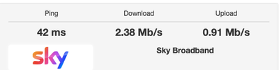

We have exactly the same issue. Sky offered us 500 mbps instead of the old 100 for £4 pcm less, so we went for it. I was also told (by the Sky Engineer who fitted the OTP that Sky have been bought out by a large American company (cant remember who) and that the culture has changed away from service levels being central to the ethos, to volume of sales being central which is why they have turned every single "visit your home" engineer into a sales guy who can switch you to a "better deal" on the spot - which is what he did. None of this would be an issue if it want for the fact that they have not done what they said - and if (as other posts indicate) it seems to be a problem with the configuration of the router then that's pretty basic - so why have some correspondants found no resiults when calling the experts (i.e. Sky themselves). FYI my LAN cable is brand new and supplied by Sky themselves.
Message posted on 13 Apr 2026 09:15 PM
Re: Got Fibre 500, still only getting 80mbps Download Speed
......amd here is the paltry result just now. 5 mins ago it was 75mbps. It is literally all over the place. Good thing I don't rely on it for work!!
