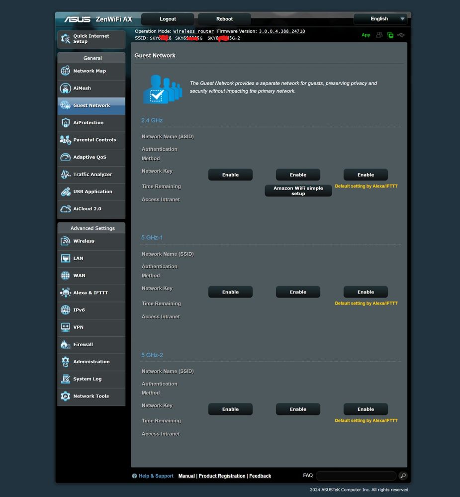

When using the XT8's as WiFi access points do they use the WiFi details from the Sky hub or does another WiFi net work need to be setup?
With this setup, is it possible to setup a 'guest network' to all family and friends to use our network but not be on the main network where lots of our devices sit.

@Whitters23 Would advise you to just get access points, the superior Asus router's like the XT8's are just way to good and expensive to waste as using as dumb AP's. Network solution you have is fine for connection, if you are going to do Asus let me know and i will look see what get's stripped out when setting asus up in AP mode. Yes Asus allows ssid naming splitting etc, have my three band names all split and using a skyQ ID from way back in the day with a SR203 password well mixed and matched.

Think that the Tp-Link's allow guest mode access to be setup, Asus does have but pretty sure you need to be in router mode operation to do so.

@Whitters23 Attached the XT8's allowed for guest wi-fi, you can see what can be done, not using so have never bothered setting or testing.
Asus XT8's Guest network
