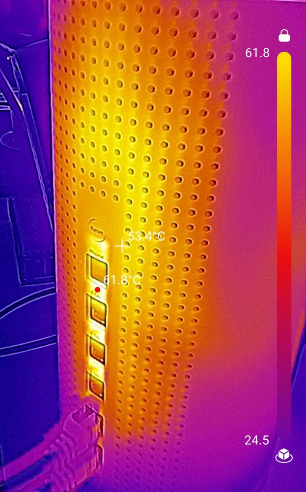

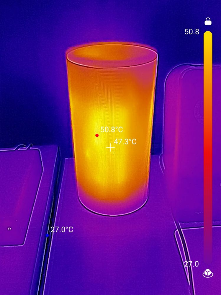

On Saturday, the router crashed/rebooted during a speed test, but I didn't think too much of it. Today (during work) I have had it crash and reboot a total of 3 times. This is with minimal network traffic, not downloading, streaming, etc. The router is very hot to the touch, so I grabbed my thermal camera to take a look. The environment around the router is not hot, and the room temperature was around 23.5C. On the outside of the casing, the front of the router is sitting at around 51C, and the rear of the router where the ports are is around 62C. I imagine it is getting a lot warmer than that on the inside, since the plastic surround does not make for a good heatsink.

@KillerCars Yes that's hot for a Hub that's not doing anything special never mind pushing the envelope, if you have a themal issue get a fan on it if you have one at home and push some air through it plenty ventilation at the back to do so. You may also be able to get sky Tech support to pull one out a box and sit it standalone doing nothing, if it was 5Gb/s would be having something sitting under it before it ruins you furniture, Plate coaster's are pretty good if you have any of the hardened type.

The temperature of 62 C is higher near the ports than I would expect but a lot of equipment does use the plastic case to disapate heat as you can use plastics which can conduct heat for this purpose like the Sky Q TV boxes. However the case should not go above a temperature which would cause you to be unable to pick up the unit which is normally around 50 degrees. Was the unit in direct sunlight by any chance?

To answer @Chrisee - no, the hub is not in direct sunlight. I have the desks positioned on a shady side of the room to prevent glare on my screens. I would like to report to Sky, but admittedly I didn't look very hard at how to do that before posting here. Regarding the plastic case, fair enough if they are trying to use it to conduct heat, but so far it seems (in my experience at least) that the hardware inside is just generating too much heat for it to handle. My MikroTik 10gig switches use the cases for heat dissipation, but they are all metal and sit at around 40C, which is warm but not worryingly so - same goes for my PoE switches powering several cameras and sitting comfortably in the 30-35C range.

The router had been behaving for the last few days but has crashed/rebooted again just now. Reading 52C on the front, 65C on the back.

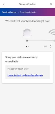

The service checker in the MySky app so far has never worked for "broadband". If I run a check manually, I get the following error:
