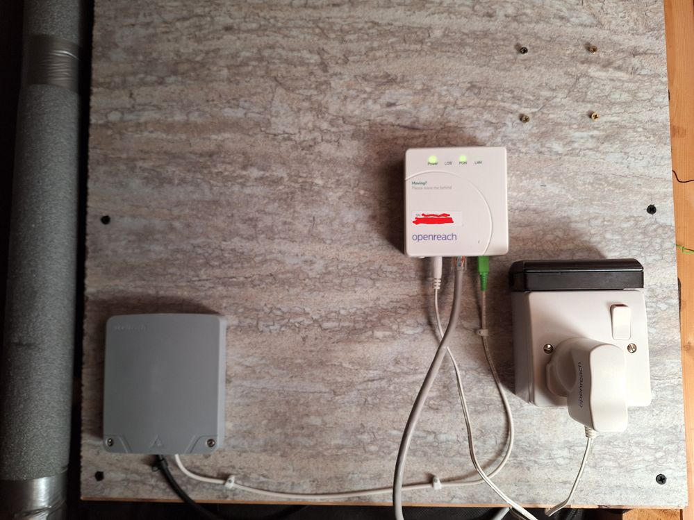

@Steven_-M No easy answer as everyone is different, but my CSP is mounted inside in the dormer roof space, so off the pole, fibre to the roofline, up the truss and mounted, see picture when it is cleared and approved for viewing. I took care off all the pre-work and OR Engineer did the rest!
CSP and ONT internal mounted in dormer space!CSP and ONT internal mounted in dormer space!
