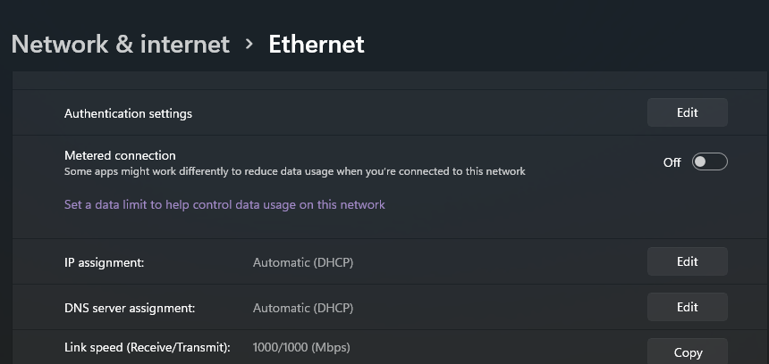

Message posted on 23 Mar 2022 04:35 PM
Re: Fibre speed question
So even though you set your adapter to 1gbps it may not actually have connected at that speed. What does Windows say its connected at under settings > Network & Internet
