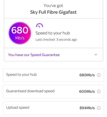

Just wondered though on speed connection if this will improve. I opted for the gigafast fibre which is rated at 900mbps. But my connection (as confirmed by mysky app) is fluctuating daily between 670 and 695 Mbps. Nowhere near the 900Mbps. However the upload speed is showing as 895Mbps so that's actually higher than my download connection.

This is a picture of the sky network test from mysky app. As you can see currently still only connecting at 680 instead of 900+ so not sure why that would be as seems a small increase over the 500Mbps package if I never end up getting the 900 speeds.

@Daveyboy1234 You have just fully understood the SR203 Wi-Fi5 speed limit, and about 600Mb/s and that is at a push will be topped out speed wise on a wireless Wi-Fi connection, the reported speed that sky see, service checker good to see the whole 30 day gambit, but it is only once a day, can be found out looking at the hub log, TR069 3 entries when it happens time really never varies so if in a CF busy time do expect to be that little bit lower and that is what sky will report, Download is always far more busier than the Upload that's why most do the split, ie mine FF500/70,
And the hub is set 549 000 70 000 so does peak a little over the 500 at times.....
Message posted on 26 Jun 2025 01:32 PM
Re: FTTP install in flat - can cable be run along ceiling?
@Daveyboy1234 Login to your hub 192.168.0.1 and the security log going to ask you for the user/password so you know look for the TR069 entry. Time is the important part, Ethernet is the really only way to prove as you got the wifi speed down pat...
