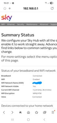

I'm trying to connect a camera on 2.4 and it says that WiFi is only 5. So I was checking to see if router was both
Re: Does this mean im getting 2.4 and 5ghz
@Hughie5 Yes your getting both, 2.4Ghz is on channel 1 and you 5Ghz is on channel 36 from your 1st post!

My router indicates that they are not synchronised as box is not ticked.

@Hughie5 And your picture showed only ONE name so you do the opposite.
