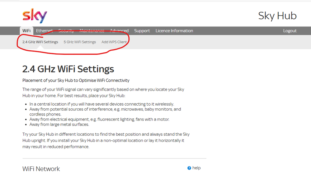

Hi there, I wonder if anyone can help me. I recently had an upgrade on my broadband to the new full fibre, since the upgrade I can no longer access my CCTV cameras either on Wifi or 5G. I have read so much about this to try and sort it out, I have tried;
- re-booting/resetting the rooter
- re-booting the CCTV DVR
- Resetting the 3 plug in TP links I have around my house
- Logging into the router to look at changing some settings as I have read that some cameras will not work on 5 GHZ and need to be 2.4 GHZ - also spoke to sky yesterday who advised this could be it and tried to go through some steps to do this however I could not see an option to turn off the 5 GHZ, there were two tabs so you could switch between 5 and 2.4 but I could not see anything about turning it off, they both had the setting enabled to say 'merge'
I am now at a loss as to what to do at all, any help would be greatly appreciated guys.
In that interface you'd can achieve a similar result by unticking the "Synchronise the 2.4 GHz and 5 GHz Settings" option, restarting the Hub and then renaming one or both bands.
Message posted on 04 Feb 2026 03:50 PM - last edited: 04 Feb 2026 03:54 PM
Re: Cannot access my CCTV cameras since broadband upgrade
@JustAndy Do you see the Enable WiFi Access Point, then uncheck and APPLY bottom off the page, that turns the wireless band off....
There is ONE for the 2.4Ghz and ONE for the 5Ghz, you click on either at the top to flip band settings....
If you have set the Hub for WANoE operation only, adjustments can be made only on Lan Ports 1,2,3 and either/or off the wireless wifi ssid's that you have Enabled for operation!
Thank you. Just tried this and still no joy 😞
