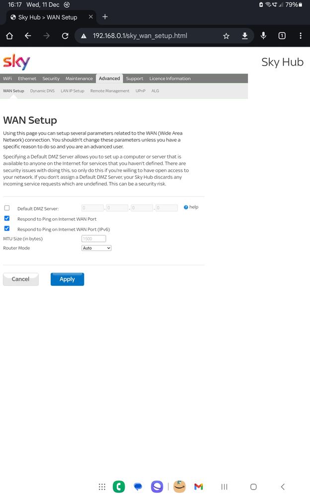

Check to make sure respond to ping is enabled

@cookiemonsteruk thank you for your response. "Respond to ping" has always been ticked. Looks like we have set up the Broadband Monitor with the prefilled longer IPV6 address, i've just updated this to the shorter IPV4 (X.XXX.XXX.XX). I'll leave this running for a while and share the results later.
