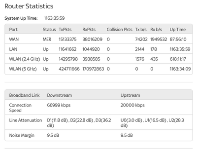

@dorset25 Please can you post your router stats so the forum can advise on any issues. This link explains how to do that https://helpforum.sky.com/t5/Broadband/How-to-find-your-Sky-Broadband-router-stats/td-p/2855717#
Message posted on 29 Jan 2024 04:25 PM
Re: Broadband speed gone down
Thanks for your reply. Here are the stats. 🙂
Message posted on 30 Jan 2024 12:56 PM
Your speed has indeed been capped by DLM likely due to the drops you had. However if the speed (67mbps) is not below the guaranteed minimum figure Sky gave you when you took the contract out then they likely wont investigate it. You may find that the speed comes back up on its own as DLM is designed to improve the line speed once it detects stability again.

@dorset25 a short drop in the esrly hours is often the cabinet resetting the connection as a result of DLM activity.
