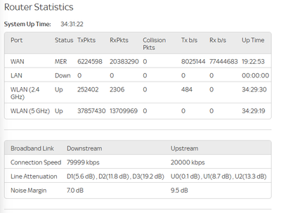

Message posted on 14 Jun 2025 12:08 PM
Re: Broadband connection dropping
Hi @JimM1 ,
Here are the stats. I will try to have a look around 4 pm when the issue occurs see if there is any change
Message posted on 16 Jun 2025 03:14 PM
Checked the stats right after it`s crashed out again.

Message posted on 16 Jun 2025 06:41 PM - last edited: 16 Jun 2025 06:50 PM
@JWielgomas Something seriously going on just look how much you have been slammed, 80Mb/s all the way down to 35Mb/s...
If i did not know better would suspect you either have a crappy Master socket filter or a really bad line. Master socket we can test if you have a spare filter lying around just need to know what type of socket and connection.
