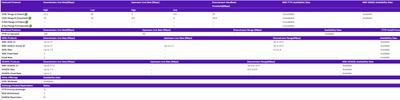

@DJT497  First of all take it you are not at your mother's property?
What information does filling out the form below give for speeds available to your mother at the property. If you can post an image of this to help us better understand what is going on with the connection.
If you could also get router stats that would be of a great help also.
Re: Broadband Speed
@DJT497
Could you enter your mums full address below and post the table after removing her address from the image

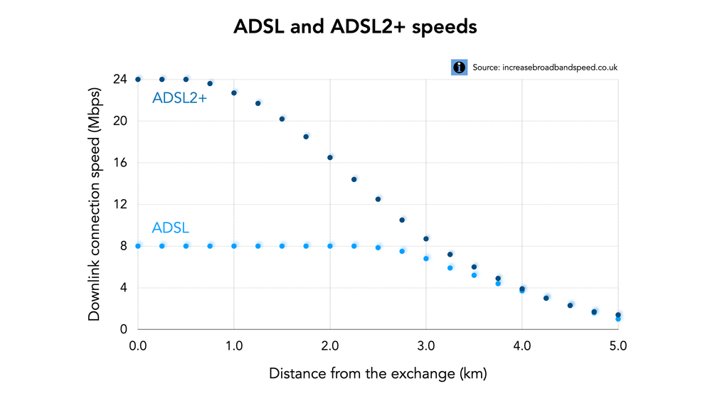

I'd note that 3.3Mbs is a truly awful guaranteed minimum speed even for ADSL, let alone FTTC, and suggests either an extremely lengthy or very poor quality 'line'.
1000001830.pngFTTC Speed vs DistanceFTTC Speed vs Distance

Thanks all.
Unfortunately, for whatever reason I keep getting the red "You do not have permission to upload images." banner appearing when I try to upload a screenshot of the BT report.
On a positive note, after multiple hoops to jump through, I've now managed to get someone [Alanna] at sky to look at the numbers & she agreed that something is not right, so an engineer callout has been arranged.
I'll keep trying to post the screenshot of the BT form, but if I can't upload it, I'll post an update once the engineer has been with whatever they come up with.
