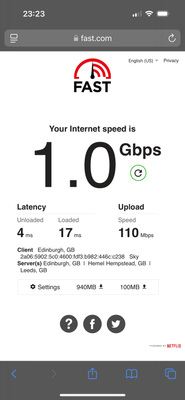

I get this next to my hub on my mobile

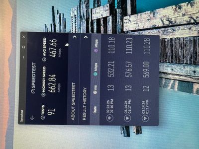

and this upstairs on my gaming pc due to the distance between devices
