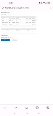

Message posted on 29 Apr 2024 08:40 AM
Re: 5ghz channel keeps changing
@Chrisee another update, the 5ghz keeps disabling as you can see from the screenshot, but the Sky boxes are currently connected on 5ghz I have 2.4 disabled on those, and the channel is still changing and halfing my bandwidth, would you be able to escalate this if possible so I could chat to someone
