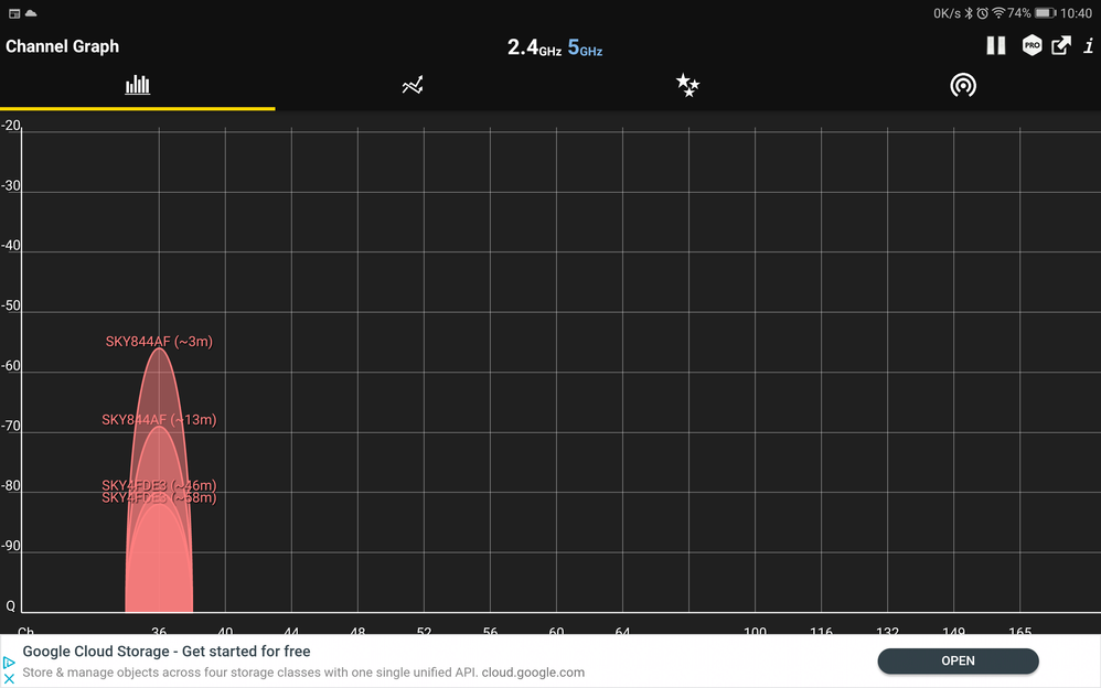

For the guys having trouble with 5ghz, might be worth trying a different channel.
Ours is on the same channel as our neighbours (see screenshot) although they don't seem to be clashing but it could potentially be an issue for other folk.
A blog I read said that changing from 80Mhz to 40Mhz can also fix it.
