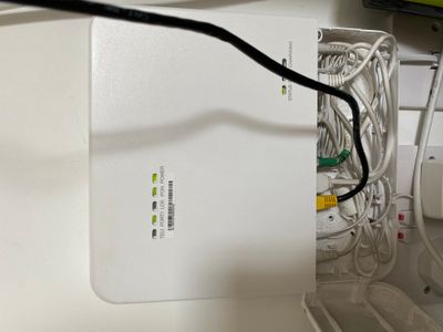

The wall? Surely you mean plugged into the ONT box if you have full-fibre (FTTP)?
Message posted on 08 Jul 2021 02:34 PM
Re: Sky Fibre RJ45 compatible modems?
Directly from the wall? Is this a g.fast mastersocket or do you have a larger open reach modem in the house

Yeah I'm getting rather confused. I dont know what it is, the building was built in the last 3 years, and the white box on the wall is where everything comes into my flat. The 'Fibre Cabnet' isn't much help either, it's litterally a bundle of CAT going through the building.

We have to wait for the photo to be approved for further comment, just to check what you have installed. The photo will take a little time to approve.

Thats a Openreach FTTP ONT you have so as @mae-3 said you should be able to plug the TP-Link router directly into the ONT and not use the Sky hub.
