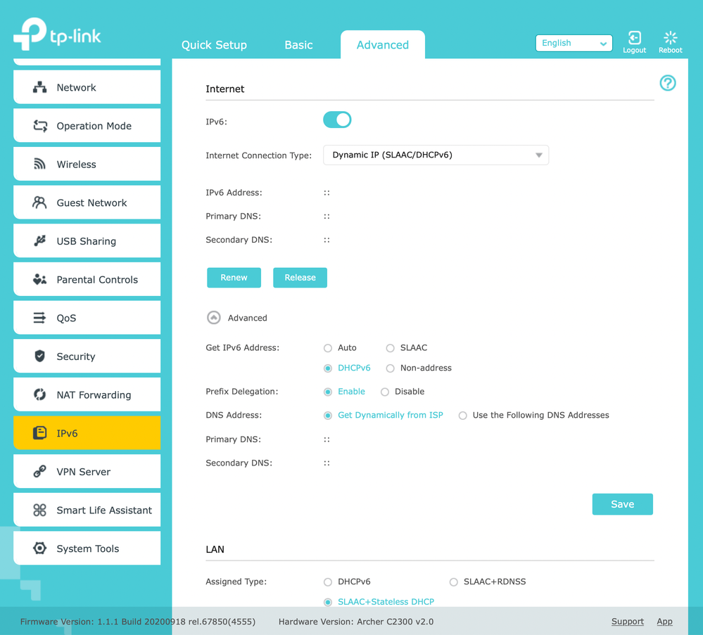

Thanks for that link @Chrisee, I've gone ahead and reset my router, enabled the Dynamic IP IPv6 option and set it to DHCPv6 in the Get IPV6 setting. Then in the 'Internet' (IPv4) setting I've left that as Dynamic. I'm not getting any IP addresses assigned and it not connecting. I've checked the system logs they're not offering up any details either. Below are screenshots of what I've configured, as far as I can tell they're the same as the ones in the linked thread.
I'm at a loss as for what i'm missing here.

Pictures didn't seem to upload properly, here they are:

@BottledUpJam
Those are the accepted steps for setting tp link to replace the sr203. Which in you case seems to be misbehaving

The Sky SR203 isn't required if you use your own router that has a WAN port (ethernet RJ45 socket) that connects to the ONT, and then the settings you have chosen for connecting to Sky will work.
If you are connecting the TP-Link AC2300 to the Sky router then the setup is completely different than that advised, eg: you bridge it or put up with double NAT.

I'm a little confused now. So the ideal setup would be my TP-Link AC2300 plugged in directly, removing the sky hub altogether. Am I mistaken in thinking I can do that, with the pictured above settings? I essentially want to remove the sky hub from the equation, even if it mean purchasing other equipment.
