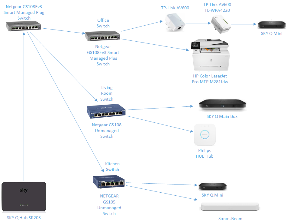

SR203 firmware update 5.14.2249.R. broken communication between WiFi and wired devices
So 2 weeks ago my sky hub went offline at 7pm. When it came back on my mobile phone could not connect to my philips hue hub using the hue app. I initially thought it was a hue problem but when I enabled out of home mode I could connect to the hub using mobile data! My hue was plugged into a netgear switch...I have 4 in my house. I connected hue directly to the sky hub and it started working again. Then I noticed that my laptops on WiFi had connection issues with my printer hard wired to another switch upstairs. Thinking it was the printer playing up I tried connecting to its Web interface via my pc hardwired to same switch as the printer and it worked. However the Web interface would not load on the laptops! I then thought I would check my sky hub and noticed it had the sip alg option I had heard about so now I worked out that the reason the sky hub went offline was because sky pushed out a firmware update. Which I have now verified....its version 5.14.2249.R.
Since after an update its recommended to power cycle all devices. I went and did just that and powered down all my sky boxes , my hub and my switches. Turned the hub back on followed by the switches in order they are connected then sky then my devices. Hey presto the communication issues between devices on WiFi and hardwired devices on my netgear switches was resolved.
Except the issue came back 2 days later!!!
It's clear that this firmware update to fix dhcp and voip timing bugs has now introduced a new bug!
Sky sort this out please! Can we downgrade to the previous firmware in the mean time? I didn't have dhcp issues and don't have a VOIP phone so I do not need this buggy firmware which has broken my hard wired network!
I spent a lot of money and time and effort to run cat6 from my router to a distribution switch in the loft which has multiple uplinks that feed down to switches in every room and now your firmware update has broken communication between WiFi and hardwired devices on 3rs party switches! As a side note my sky q main box and 2 mini boxes are all hardwired and all 3 have WiFi AP disabled so only my sky hub provides the Wifi

Message posted on 05 Mar 2021 12:36 PM
Re: Sky Hub SR203 Feb 2021 firmware update 5.14.2249.R. be communication between WiFi and wired devi
Hi Chrisee, thank you for your detailed response
I have netgear switches, the hub has an uplink to a managed netgear switch in the loft. This feeds down to a managed switch in the office (where printer and PC is connected) and 2 unmanaged switches in other rooms one being the living room (where philips hue was connected but had to be moved direct to hub). The managed switches are not doing anything fancy, just default settings. I only got them really because they can do line tests so I could verify my cabling throughout internal walls was not damaged during installation.
So I disabled my WiFi hostpots for 2 reasons. One was the WiFi speed was not as fast as connected to the main hub. The Hub was in the living room next to my SKY Q box and the mini boxes in bedroom and kitchen and as they were all within close vicinity to each other my mobile phone could connect to different access points. As I work from home and use Jabber for company calls when it switched access point it could cause my calls to disconnect. Also if I was connected to the mini box and I went outside in the garden I would loose connection and it would connect to the mini box behind my kitchen TV and the connection was not great. I since moved the hub to a central location in my house under my stairs in a cupboard and turned off the APs on all 3 sky boxes. Now I have done this the hubs WiFi reaches the whole house and to the bottom of my garden without needing multiple SSIDs causing issues when switching between them. I also had issues occasionly with the Sky Q mesh so hard wired my Sky boxes with Cat6 and Gigabit switches. So I know your saying its the switches fault but it worked flawlessly until the firmware update.
All my devices show connected on my hub and all are pingable including my philips hue and printer but accessing the hub hub via the app and the web interface of my printer does not work from any device on WiFi now. I have tested with 3 laptops and 3 mobile phones on on WiFi, as soon as I plug the laptops into ethernet they can get to the printers web interface. Or if I plug hue direct into the sky hub it works on WiFi.
So this is 100% a communication issue between devices on WiFi talking to devices hard wired to a switch connected to the Sky Hub. Not all traffic is being blocked through, ping works and although my printer says offline on the laptops, once I run the troubleshooter it reconnects and can print but not access the web interface.

Message posted on 11 Mar 2021 02:24 PM
OK so after much troubleshooting I have think I have found the cause of the problem
As per the diagram below, I have a SKy Q mini in the bedroom bridged to the office switch via powerline adapaters. As soon as I connect the ethernet from the Sky Q mini to the powerline I cannot reach my Hue bridge or Sono via the apps on my mobile connected via WiFi, nor can I get to the web interface of my printer via a web browser on my mobile or and WiFi connected laptops. As soon as I unplug the SKy Q mini connectivity is restored. To prove it was the powerline adapater I connected a long ethernet cable from the Sky Mini directly to the office switch and the issue does not happen.
So although the issue is caused by the powerline adapater, this has been working for 6 months and only started causing issues with the latest Sky SR203 firmware update.
I was thinking of running wireshark to see if I can see what is acvtually going on here but it definately looks like its to do with the way the SKY Q boxes talk to each other generating some traffic is not playing nicely with the powerline adapaters.

Message posted on 04 May 2021 02:36 PM
As a follow up, I think the lower level reason in your case was because the TPLINK AV600 does not seem to forward tagged packets as others have mentioned in the past - See
https://community.tp-link.com/en/home/forum/topic/105744
I think that Sky Q devices expect wired ethernet links to be able to work as trunk links and some switches or media convertors which can't forward tagged VLAN frames (802.1q) will interfer with things. Non tagged frames can pass through fine, so doing tests yourself between a computer either end will make the link look usable.
I think that when Sky Q first launched it didn't do this and would consider wired ethernet links as non trunk. Most of the special sauce of Sky Q was around wifi and its own powerline which later got dropped. I think for whatever reason Sky Q now wants to be able to have different VLANs working over single wired links (trunking) and this will break existing installations that have old devices unable to forward 802.1q ethernet frames.
