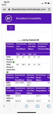

How do I know what cable is being used? It's just the basic Ultrafast, not Ultrafast Ultra.
Message posted on 28 Sep 2021 03:57 PM
Re: SR203/204 routers with TP-Link Powerline
@Slider09 enter your full addres into this checker https://www.broadbandchecker.btwholesale.com/#/ADSL/AddressHome
If the results list FTTP - not FTTP on demand which is different - you are likely to be on fibre. If there is an entry for G.fast that is the technology you will be getting. If you post the results remove your address first.

Not letting me post images. No mention of G.Fast or on demand.

The image has been posted but needs approval before those on the forum can see it.

Says featured product
WBC FTTP
up to 1000 Mbps downstream
Message posted on 28 Sep 2021 10:31 PM
That means that the broadband is fibre directly to the home and is the best and that TP-Link Powerline homeplugs are fully compatible with that method of connecting broadband system in the home. The only deciding factor will be how good the electrical home wiring is in your home on how fast they will operate on the local LAN wired connection PLC, eg: usually operates at about 100Mbps or faster on the LAN with powerline technology.
