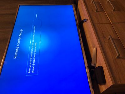

Please help I get this after unplugging then plugging back in while holding the power button as suggested can't get the puck back now

@Dave+r+robbo thst is recoverable press 4 & 6 on the glass remote for 15 seconds then release at which point the screen should tell you to press 1&3 together again allow for 15 seconds which is far longer than most people think I used a watch to time it. Thst should repair the remote with the unit.

Nope that's not working oh heck

Got no light on the puck at all

@Dave+Robbo try unplugging the power and hold down the puck power button for 20 secs whilst plugging power back in
usually gets a red / yellow flashing light that forces a reset and update

@RedJen1980 wrote:@Dave+Robbo try unplugging the power and hold down the puck power button for 20 secs whilst plugging power back in
That usually works, you may need to activate the puck again within your Glass Account.

@Dave+r+robbo connect it to the WIRED network - use an ethernet cable connected to the router...
