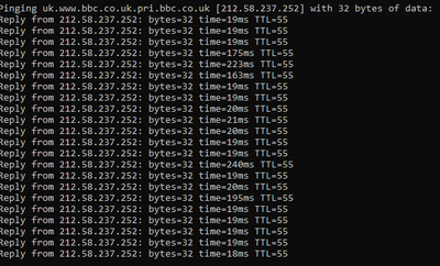

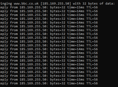

Yep, I'm on wired ethernet, under 1ms.  Interestingly when I switch on my VPN my ping to www.bbc.co.uk goes to normal, check out the results below.
Without VPN
With VPN

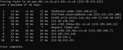

Because ICMP (ping) is low priority on routers on the internet and other traffic is at a higher priority it's not impacting VPN traffic. But it does mean that a router on the route to the bbc.co.uk is likely slightly congested. Can you do a traceroute to the bbc.co.uk to see whether it's a Sky router, that is most likely, without the VPN in the circuit, please?

Here you go 😀

It seems that it is only impacting the BBC ICMP network router traffic which is low priority and ICMP is only used for diagnostic purposes. I doubt it is impacting normal UDP/TCP traffic, and the only thing that would be done is to add capacity at the BBC to handle capacity in the future.

Re: High latency causing lag on gaming and general speed issues
what about where it says "226ms - be105.er12.enslo.isp.sky.com" ?

But the average latency is 17ms, the first traffic ICMP traffic took 226ms because of its low priority but the traffic later took an average of 17ms.
Are you getting issues watching the BBC, and more importantly what games have issues, and whether it's a console or PC? And speed looks good at 27Mbps downstream for the distance to the cabinet, is the guarantee minimum speed above that speed?
This message was authored by: mrpugster
the spikes are the problem, and that I think is what is causing the lag on BF3 - I had a constant ping going on the 2nd screen and the results compare to the lag I get when playing.  As soon as the VPN comes on it dissappears - no spikes whatsoever.  Either way I shouldn't get a better experience on a VPN no matter how you chop it up.

"what about where it says "226ms - be105.er12.enslo.isp.sky.com" "
Looks like for whatever reason sky are routing you through Birmingham hence the longer times
