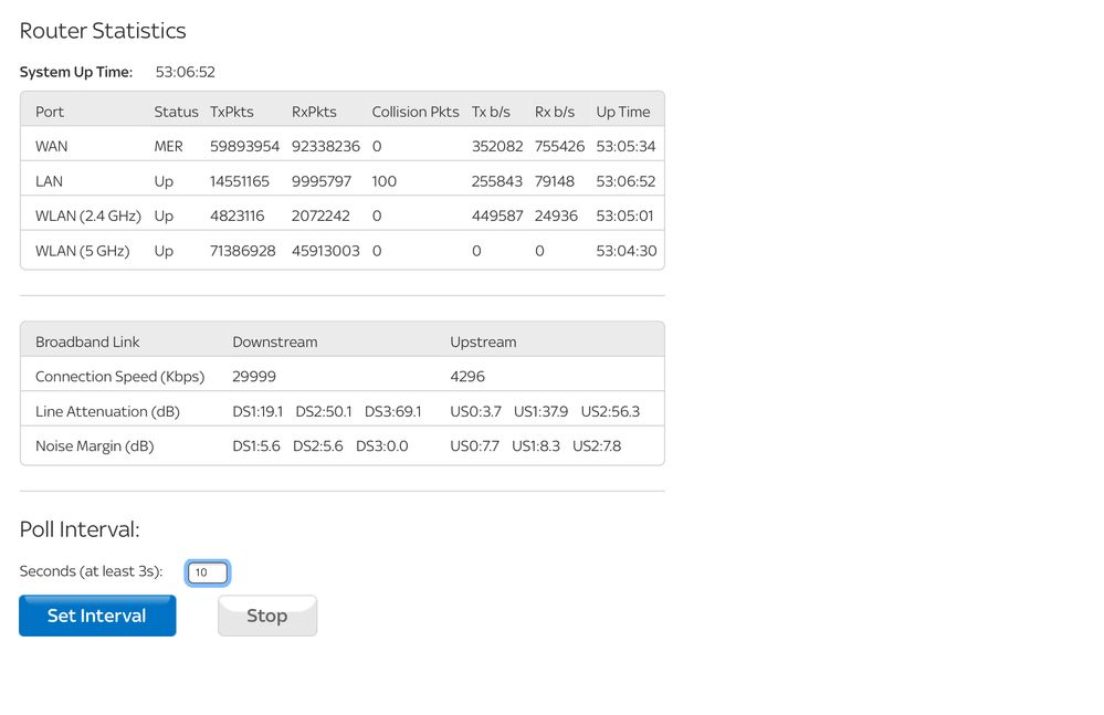

Below are my router stats:
So despite this, I have a steady connection speed. Everytime I've rung Sky about slow broadband, I've been told my connection is fine. Which I can see. I even ran a program called Routerstats Lite for about 18 hours, and only showed a few disconnection/connection speed drops (About 4 times)

Hi @SEBUK
Your issue looks to be WiFi because your router is reporting nothing has been connected to the LAN interface since the router was last rebooted

Something else I've noticed is your upstream noise margin is high and it's in this direction that streaming is taking place in your case, so it's likely saturation when uploading/streaming. This may sort itself out if the router isn't rebooted for about 3-4 days with DLM and offer slightly more upstream bandwidth which is likely the issue and difference during the last 2 week period?

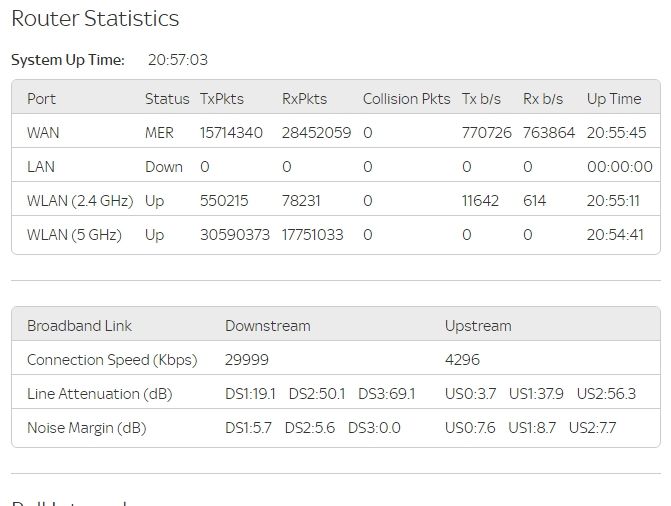

@jamesn123 and @mae-3 @thanks for your comments so far. I will test my next teams meeting wired. It seems my previous screenshot showed the LAN as not being used, it seems like that was an error, as I've just checked via stats and got shown it is in use, as per screenshot.
im not rebooting the router as shown by uptime so far, will see if it improves.

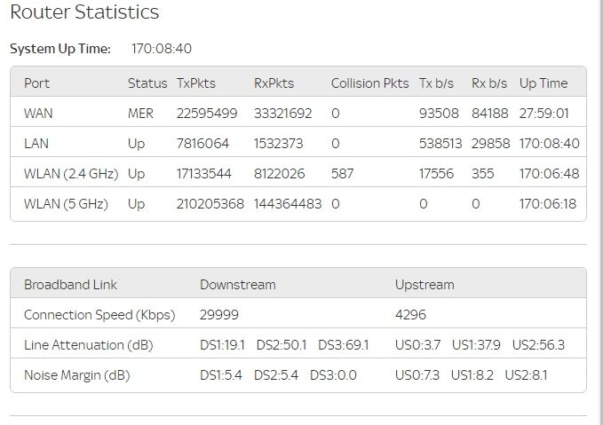

Router stats again. It was mentioned a week ago that my upload noise might be too high?

@jamesn123 @Yup, Ethernet. I know, they're horrible. Hehe. What do the line stats look like?
Message posted on 13 Apr 2021 05:16 PM
Re: High latency causing lag on gaming and general speed issues
Banded still, with a dip in upload. All around not an ideal connection

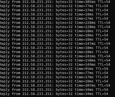

hey there, did you get this fixed in the end? I'm getting exactly the same as you. Fine pings and then massive spikes when playing BF3, streaming locking up for no apparent reason. Had new Openreach Master socket fitted January, it's not been quite right.
On my 2nd router, first one all the ethernet ports didn't work, not tried ringing Sky but will do tomorrow as I've reached the point where I'm fed up with it.
This is ping from www.bbc.co.uk
