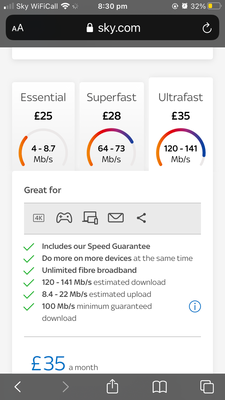

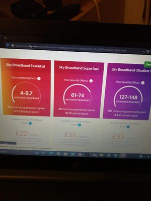

I was wondering if anyone would know why the gfast speeds on my line have dropped substantially. When I first moved into this property a few years back I could get speeds on g fast of up to 145-148mbps download and 15-25mbps upload. Back then my internet speed needs weren't that demanding but now they've gradually increased. I was interested in purchasing g fast for my line but found out that my speed range is now only 120-142 download and 8.4-22 upload. Vdsl2 speeds aren't too bad on my current package. Even property's that are close to the cab that used to get 150mbps speed range now only get 143-144mbps. Would openreach or sky have to upgrade their equipment in the exchange or the cabinet? Also would an increase demand of g fast orders be a factor of the speed drop? Any advice appreciated.

@mae-3  Nothings changed in my home. I'm about 40m from the green cabinet. I've noticed a new little g fast Pod thing on the telegraph pole outside my home too. I'm not one to constantly reboot the router either. Would there be a time when openreach re instate the speed in a way? A few months later it'll be ranged almost the same as a fttc connection. My line stats show 6.1db downstream and 13.3 upstream. Line makes noises sometimes but it's probably my handset.

Sorry, I'm currently on a fttc connection. 80/20. I was considering g fast but as I explained the speeds quoted for my line are dropping numbers each month. If I reported this to sky could they do anything? My contract for my current package ends in September so around that time I'm hoping the g fast speeds quoted on my line should be higher.

Speed estimates (which is all they are) will be generated from Openreach data, and may well be more accurate now than when they first appeared.  Realistically you have to accept that G.fast is an inherently more variable technology than FTTP.
