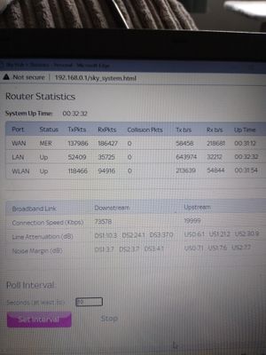

I have sky broadband.
74mbps
Guaranteed 50 something
I have ran health checks for the last few days and showing 74-75mbps.
When running speed checks on my devices. I am lucky to see 15mbps.
Have ran it once via LAN where I have had 20.
Not ran at peak times.
On speaking to SKY they tell me this is normal and that my devices only require 10mbps.
Further explanation was given that the router was rationing bandwidth to devices if a few were connected.
When I explained it was still the case with one connected I again was told this was the case.
I was then told never to expect more than 10-15mbps to any single device.
Even asked if I upgraded to 154mbps would that make any difference and got told I still would only receive 10-15 Mbps to any device.
Before they hung up on me anyway.
Is this right?
It just doesn't sound right.
I have a picture of my router status but have to figure out how to make it smaller....

@Slowspeed1954
Go back to router->support page and copy and paste your syslog and take a wee look at the ethernet just before the plug and tell me what category ethernet is on the sheath
Re: Broadband speed to devices
@Slowspeed1954
Had another look, you have a very old sr102 with only a 2.4ghz wifi band. How on earth does sky think that can handle up to 80Mbps is beyond me . It was designed for adsl up to 24Mbps. Need a new router either sky or 3rd party

So if I am reading this right.
Sky should have picked up on this straight away and when I upgraded last year to faster internet should they have sent me a new one?
And I will struggle to get more than the speeds I am getting because it is pretty much a dinosaur.
Maybe they realised it was an old one when they hung up on me.
Does any of what they said ring true. That devices only use the speeds they require. And I would never get anywhere near my stated line speed.

Appreciate all the replies.
I know the WiFi speed tests are a little wishy washy. But it's the same via LAN.
So back to sky ask for a router as mentioned above and eventually get the speeds I have been paying for for 9 months.
I do understand that devices only use what they need. But my question to sky was
" That if I had one device connected, surely it would show all the bandwidth available and not just 10-15 Mbps."
Turns out maybe that is all the bandwidth available....

Lisa. Appreciate the answer and hub.
However not 100% accurate, the a new contract was taken out last September and the broadband was spoken about then and duly increased.
The hub I have at present is probably 5+years old.
So I did take out a new contract in September 2020. Took out the faster internet, but the hardware wasn't sent out or made available.
Until I raised an issue yesterday/today.
When I took out the new contract, surely it would be seen on the system that I would be unable to gain the speeds with the hardware I had?
Or if not it would show the hardware that I had present at my address/account.
Too sum up a new contract was started when the faster broadband was applied. But the hardware was not upgraded at that time.
