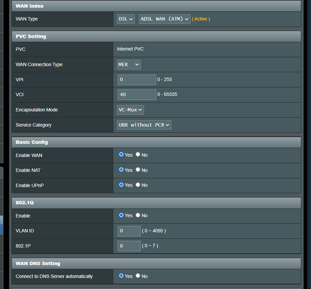

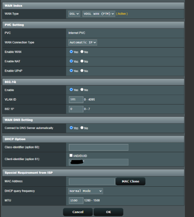

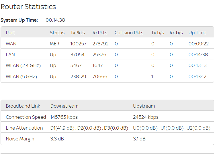

Hi, can anyone help me try get this device working with Sky superfast broadband please.
I've upgraded the firmware to the latest version then tried the auto setup selecting Sky Mer which gives the below settings on the ATM profile. I've tried adding VLAN 101, setting DHCP query to normal and MTU to 1500.
I've also tried creating the profile as PTM with the settings from another post. Tried client identifier with the @Anonymous| side of things too.

Message posted on 09 Feb 2022 10:17 PM
The router you have picked is not G.fast capable on your G.fast broadband connection, basically, it will never work connected directly to the G.fast broadband line.

Message posted on 10 Feb 2022 12:00 AM
Re: ASUS DSL-AX82u Setup help
Thanks, was told it was compatible doh! Will return and try find something else that is.
