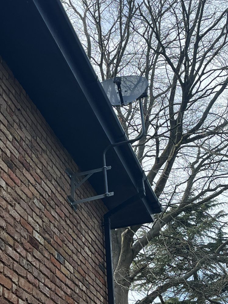

Hi All,
Just reading this thread. I left Sky in November 2020 when we moved house as the Sky Engineer said he couldn't install a dish due to the trees at the back of our house. At the time the sky engineer told me to use a private third party installer as they could gain better access than he could.
I have left it 18 months and thought I would try again with a third party installer, who have managed to find the exact spot and installed a dish (see attached photo)
Having now read the thread.... will sky have a problem with this installation / not allow me to return to Sky?
