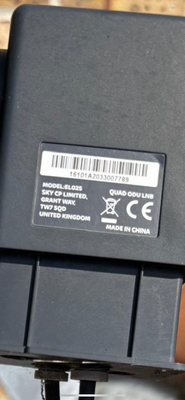

Hi, I am moving into a property and wish to get a second hand sky box to view free view channels. I took a look at the lnb on the satellite to try see which box I need but I cannot seem to find a certain answer online.
could someone please tell me what sky tv box (sky+ or sky q) would be compatible with this lnb?
it states it is a quad ODU LNB model EL025
pic attached

I am fairly confident that the LNB is 4 'Universal' ouputs as used by SKY HD boxes rather any form of 'Hybrid' with Wideband outputs but I will tag our kind expert @Godfrey who should be able to confirm
TBH I think you may be better looking at Freesat Boxes depending on their age, as SKY HD boxes are now very old
Many TVs also have single (or even 2) Satellite inputs which also use UNiversal inputs although many no longer support Freesat EPG/functionality and are limited to Now & next type info
As @oj01 all SKY Q boxes (which need Wideband outputs) are always owned by SKY and also no use without a subscription (even Essentials for FTA) anyway

I agree with @nigea99 that this looks like a standard LNB designed for use with Sky+ boxes or older Freesat boxes. It will work with an old Sky+ box, as a receiver of the free to air channels. You would need a subscription to be able to record or watch Sky's premium channels. Sky won't sell you a Sky+ subscription if you don't already have one.

I have no idea if anyone is selling them on EBay but if you do look at a used SKY +/HD box for viewing live FTA channels make sure it is not an old SD only box - most SD channels have changed transmission type and no longer work on the SD only boxes
