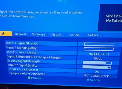

@Linzibee1 What are your Signal Strengths/Qualities? Take a look at the link below:
See question Q11 in my Sky Plus F⋅A⋅Q for Signal Strengths/Qualities

Yes it's Sky+
Message posted on 18 Dec 2025 08:38 PM
Re: Only some channels available
Input 1 is broken it should look a lot like input 2
See question Q23 in my Sky Plus F⋅A⋅Q for No Satellite Signal
"No Satellite Signal" is an error generated by your Sky box, it has nothing to do with broadband (Internet connectivity) and usually indicates an issue with one or more of the following
- The Dish is misaligned (not all transponders are getting through, thus some channels may be affected and others not)
- The Tuners in the sky box
- The input sockets on the Sky box
- The plugs on the cables
- The cables themselves

In that image, in the top corner, the mini screen is telling you that you have no satellite signal, so you need to follow the advice from @Annie+UK because Sky no longer support Sky+ set ups.

I have an engineer booked for Tuesday but was wondering if there was another way around it.!
Message posted on 18 Dec 2025 08:46 PM - last edited: 18 Dec 2025 08:47 PM
@Linzibee1 Unscrew the Input 1 and 2 cables from the Sky box and swap them over 1>2 & 2>1, screw them back in finger tight
Then check the signals again
Message posted on 18 Dec 2025 08:48 PM
Hiya, I've done that already. And tried a different box. Sadly I think it's probably a problem with the dish 😔
Message posted on 18 Dec 2025 09:09 PM
@Linzibee1 until your dish is fixed, you could set Single Feed Mode so that your Sky box works normally, albeit you'll only be able to watch or record a single live programme. The working dish feed will need to be connected to Dish Input 1.
