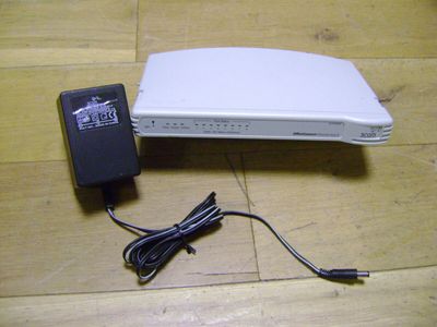

I am trying to assit by having another go with Wireshark. But to get any meaningful data I need to find an ethernet hub rather than a switch to connect both my sky box, laptop and ethernet cable to my router to. So everything trying to advertise itself as a hub is actually a switch. It needs to be a hub as they send all packets to all ports and switches don't.
This message was authored by TheRealFixer This message was authored by: TheRealFixer
Re: On demand download failure Sky+ on 2 boxes
@MogwaiSatTVIf you can't find a hub, a switch with port mirroring (I think the Netgear GS108 can do it) might be easier to find.
Phil.
This message was authored by MogwaiSatTV This message was authored by: MogwaiSatTV
Do I need to do anything to it to make it mirror or does it just do it by default?
@MogwaiSatTV You may need to check the exact model version and YouTube videos, it's not a model I have experience with.  But a second hand switch with port mirroring is probably cheaper and easier to find these days than a genuine hub.
Phil
looks like the netgear Gs015e can do it. So I will get one of those and see what I can desern from Wireshark
This message was authored by emteepeeess This message was authored by: emteepeeess
Sky+ onDemand still not working
We're almost at 10 weeks into this problem - still no ability to download any onDemand programmes, other than BBC or ITV.
Has anyone had any update info?
This message was authored by Mark39 This message was authored by: Mark39
Re: Sky+ onDemand still not working
@emteepeeess I've added your post to the existing thread, as Sky said they would update this thread when the problem is resolved.
No-one will have manufactured a ethernet hub  for at least a decade: the silicon which they used would be unobtainable now.
" As of 2011, connecting network segments by repeaters or hubs is deprecated by IEEE 802.3 "
You might find some on eBay for a few pounds as technology curios: 3Com had true hubs in their 'OfficeConnect' branded range back in the day (around the turn of the millennium) for example.  I was buying them in the mid 1990s because there was a considerable price premium for switching.
