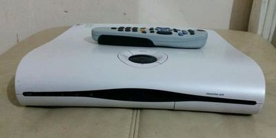

I’m hoping someone here might be able to help. I’ve got an old Sky box (I believe it’s a Sky SD model, it is the same as the attached picture below) and we’ve stopped receiving certain free channels like BBC and some Asian/Punjabi channels such as Sikh Channel.

Sky SD boxes are obsolete now. Many channels have either stopped broadcasting in SD or are using the "DVB S2" transmission mode that SD boxes can't receive. You will need to try and get a Sky HD box (they are usually available on eBay). This will receive all the free channels.

Search for DRX890 (has a HDD but that requires a subscription to use) or DRX595 (no HDD) or if you want a new box a Freesat box😉

It looks like the easiest option will be to purchase a DRX595 or DRX890 from ebay as it will not require any subsciption of any sort. We do not record any programmes and only use free channels. Is either box a better option or would the cheaper option be fine for the future.
I have found the following:
DRX595: £20 from ebay
DRX890 £40 from ebay
Thank you

DRX595 will use less power as it does not have a Hard Drive which you only need for recording also there is less to fail on you 🙂 This box will have a much older version of the software but I'm not sure this is a negative as the software was mainly updated for extra features a DRX595 cannot use
