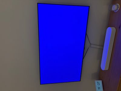

Sky stream
I am constantly having issues with Sky Stream. I’ve not had uninterrupted viewing since moving over to Sky. It's atrocious. I've checked the Wifi connection and it's 912 Mbs. …just Stream fails to work.
