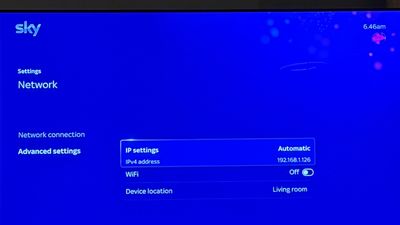

Every morning I switch on one if my pucks which is hardwired with a cat 5 cable directly to a port  on my new EE hub it gives me a blue screen saying no wi fi connection even tho wi fi is turned off -.

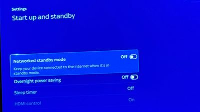

You need to have Network standby set to On.
Your setting for Overnight power saving to Off is the preferred option.
When you make a change to any of these options, you need to do a settings restart as below to make sure the option is set.
Also, it is not wise to turn the power switch off or remove the plug overnight for a puck.
Just use the remote control to switch off the puck, so it stays in standby.
The puck runs on a very low power in standby and it also does updates overnight.
Switching off for a long period will disconnect it from the network and will cause problems on wake up.
A short power restart of a few minutes or a restart using the settings restart option is fine and will keep the network connected.
Settings restart:
Go to Settings>Systems Management>Resets & Updates
Select Restart device
Your Sky Stream puck will perform a reboot. It will take a few minutes to complete

Unfortunately made absolutely no difference still says no wi fi connection even tho wi fi is off and it's connected via  cat 5 to my hub
