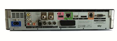

Sky+ HD boxes had a terrestrial television passthrough capability via an aerial socket: this has been posted about numerous times by users moving to Sky Q and losing signal from an aerial which was being fed through the previous Sky box to internal coaxial cabling and television tuners. DTTV can typically be restored by rejoining the now discontinuous cables behind the new Sky hardware.
On the DRX890 above the aerial socket is below the left hand dish input.
