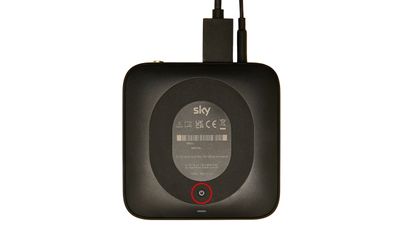

Can you try the following;
  1. Switch off the Sky Stream puck at the mains again. There's no need to unplug it.
  2. Press and hold the standby button on the bottom of the Sky Stream puck.
4. Keeping your finger on the standby button, switch the power back on at the mains and wait 10-15 seconds until you see the LED lights flash different colours, then remove your finger.
Important, Keep your finger on the button until you see the lights flash.
5. Let the Sky Stream puck complete the recovery process. This can take up to 15 minutes, depending on your broadband speed.
If that still does not resolve your issues, try this.
1. Turn your puck off at the mains.
2. Hold down the Standby button on your puck for at least 30 seconds, then turn your puck back on at the mains while still holding the button.
3. Leave the puck powered on for one hour.
4. Press the Standby button on your Sky Stream remote.
5. Turn the puck off at the mains, then back on again.
If it is still does not resolve your issues after this, afraid it may be best to call Sky, who may ask you to do a factory reset. We do not recommend doing a factory reset, unless Sky have asked you to do so and you are are on a call with Sky. Doing a factory reset can cause some account issues, that only Sky can resolve.
Sky may also send a replacement puck to you.
The contact details to call Sky are on the last page of the Sky help article above, clicking on 'No, I still need help'

This message was authored by: JayneP39
Re: Issues with Sky Stream
Thank you @lettice that fixed it!! Strange its both pucks but its finally working. Thank very much!
