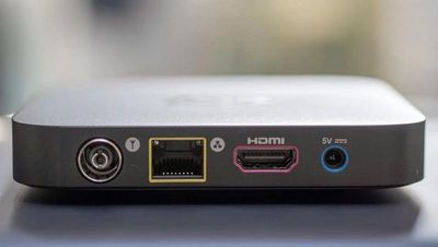

Why does the HDMI cable supplied with the Sky Stream puck have one end pink?
Does the pink end go into the puck, or into the TV?

@Tsunchke Sky's video guide shows the cable having both ends pink! It doesn't matter which way round you connect it - pink to Puck or pink to TV.

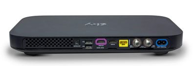

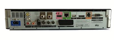

Multiple generations of Sky television hardware have had sockets marked with different colours: this is just to facilitate easy to understand instructions.
"pink cable end to pink socket" rather than "HDMI cable end to HDMI socket"

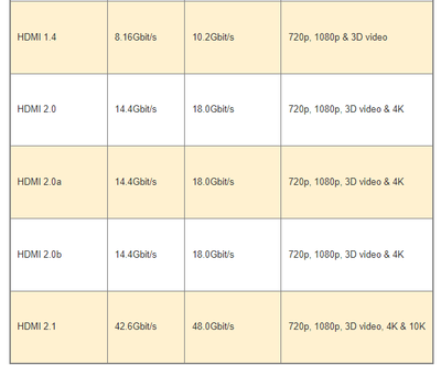

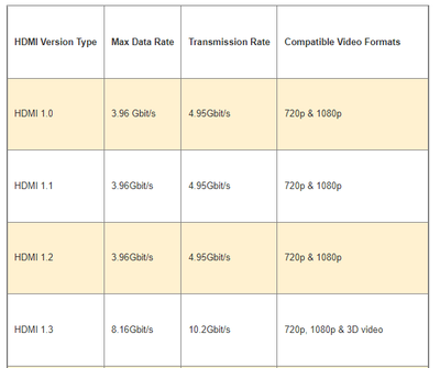

To be fair, HDMI standards aren't entirely straightforward. The key point is that everything before the 2.0 version doesn't support 4K at 60Hz which a puck outputs as 'UHD'.
( Tables from https://my.rs-online.com/web/content/discovery/ideas-and-advice/hdmi-cable-guide )
