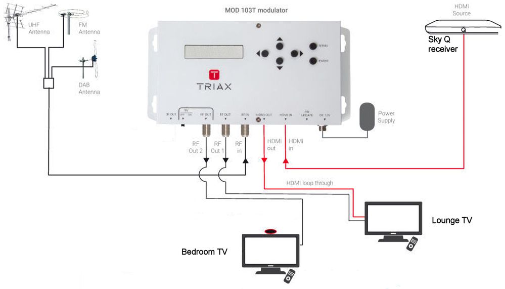

I have Sky+ in my lounge, but have connected to my bedroom via extension cables. Will it be possible to repeat with a SkyQ box? Thank you.

A typical, but not cheap, method of achieving your original objective.

Sky Q does not have the output connection required to retransmit over coaxial cable in a 'magic eye' distribution, if that's what you are referring to.

Q only outputs via HDMI - extending this is possible but not straightforward.
Sky will lend you a minibox but requires a multiscreen subscription to run it.

Message posted on 11 Jul 2024 06:24 PM
