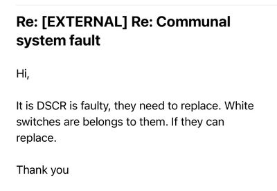

I had a sky engineer out and he checked....I'm going by his email....

@Amcevoy As a starting point, if it is just a defective dSCR multiswitch that requires replacing, the basic trade price for a 4 port Whyte dSCR multiswitch ranges from around £136, up to a 16 port Whyte dSCR multiswitch that costs around £505.
A suitably qualified 'system' engineer can be found on the website run by The Confederation of Aerial Industries, which has Sky listed as a 'supporting associate'.
So, to get an estimate, have a look here; Link to Get Me Viewing website and search for an ' Approved System Installer' in your area.
Godfrey.

I've emailed the engineer again to clarify if it's the multiswitch or dCSS adaptor. Thanks for your help
Message posted on 26 Jul 2024 01:54 PM
Re: Unitron dCSS-422
@Amcevoy If your Sky engineer found out that a Sky Unitron dCSS-422 adaptor was faulty they would have replaced it.
Godfrey.
Message posted on 26 Jul 2024 02:11 PM
Ah ok so it'll likely be the multiswitch then....
