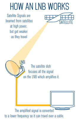

@MabelButlin If it was Sky Q you upgraded to then you do need a dish as all live channels broadcast over satellite. I would love to know how your OH thinks you will get these channels without a dish on this particular type of box.
If you have an existing dish that would only be changed if it was too old and had deteriorated, upgrading from Sky+ to Q in many cases may only needs the LNB (the bit on the dish the cables attach to) changing.
Only Sky stream is dish less and it sounds like this wasn't what you upgraded to as this does not need an installer as it would be self install.

'Upgrade' from Sky+ HD to Sky Q? Worth noting that despite what some information sources state, reception by Sky+ HD isn't ending.
I agreed to have the engineers. They duly arrived but much to our surprise they wanted to get on the roof to change the Sky dish.
It's typically a swap of the LNB on the dish, not the dish itself. The standard LNB used by Sky+ cannot pass a signal to Sky Q.
My OH refused permission for them to drill holes in our Grade 2 Listed building.
Even for an LNB change, they need a ladder tether. Without that they would be subject to potential disciplinary action if they proceeded with the job.
Now he's saying it was a con and the signal doesn't come from the dish anyway...
He's presumably thinking of Sky Glass/Stream (released in 2021), not Sky Q (from 2016 onwards)

@MabelButlin Rest assured, the message you will have received said that your Sky+HD box would no longer receive updates. This is actually nothing new as there haven't been any updates for a couple of years. So nothings changed.
As mentioned above, the dish itself doesn't need changing when switching to Sky Q, but the LNB on the dish does. So, I guess he was half right (and half wrong 🤣)
