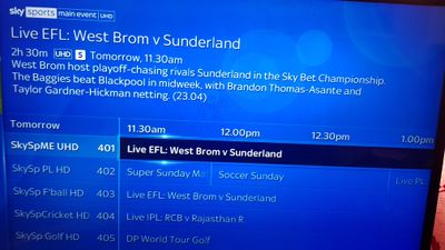

These are the ones I have tried but they don't work for some reason. Why I was asking. I can access all the HD/SD channels that way just not the UHD channels.
the simple solution to all of this is to have UHD channels for both the SSpremier league and SSfootball channels. Solves all problems bar the fact you can only record 2 UHD channels at once despite Sky's marketing still advertising 5/6 channels
Message posted on 22 Apr 2023 01:34 PM
Re: Sky Sports Ultra HD
@JackintheSkyQBox wrote:These are the ones I have tried but they don't work for some reason. Why I was asking. I can access all the HD/SD channels that way just not the UHD channels.
@JackintheSkyQBox SSPremier Leaque have matches in UHD and So does SS Football which will be streamed on SS ME/UHD at the same time if available via the red button
So I can record SS ME/UHD SS F1 UHD and record either one or both in HD and watch live in UHD all at the same time.
Do you have the UHD subscription and is your tv set to 2160@10 bit?
