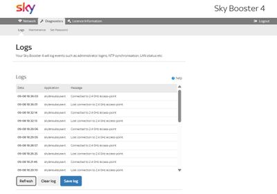

I accessed the Sky Booster 4 admin portal and was concerned by these logs, I'm not sure whether the 'access point' is my router or if it's referring to one of the boxes (I seem to recall seeing my router being mislabelled as an access point elsewhere in the portal, but I can't locate this now) but hopefully this may help locate the issue? Appreciate any recommendations.

access point is almost certainly the booster itself. Why do you have a Q booster AND a normal sky booster that's only supposed to work or at least be used with sky broadband? I would just use the Q booster because it acts like a sky router's wifi and the whole system tends to be more stable when the Q boxes think they're using a sky router. I think that has an ethernet socket, like the booster4.
