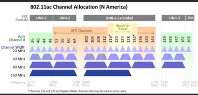

Channel 36 is the frequency starting band the internal 5GHz wifi on the Q uses and you can't change it although you can reduce its bandwidth from 80 to 40 MHz via the installer menu on the Q, to reduce the number of channels it overlaps with (as per this diagram)
If your router is also using channel36 or up to 48) it could be interfering.
